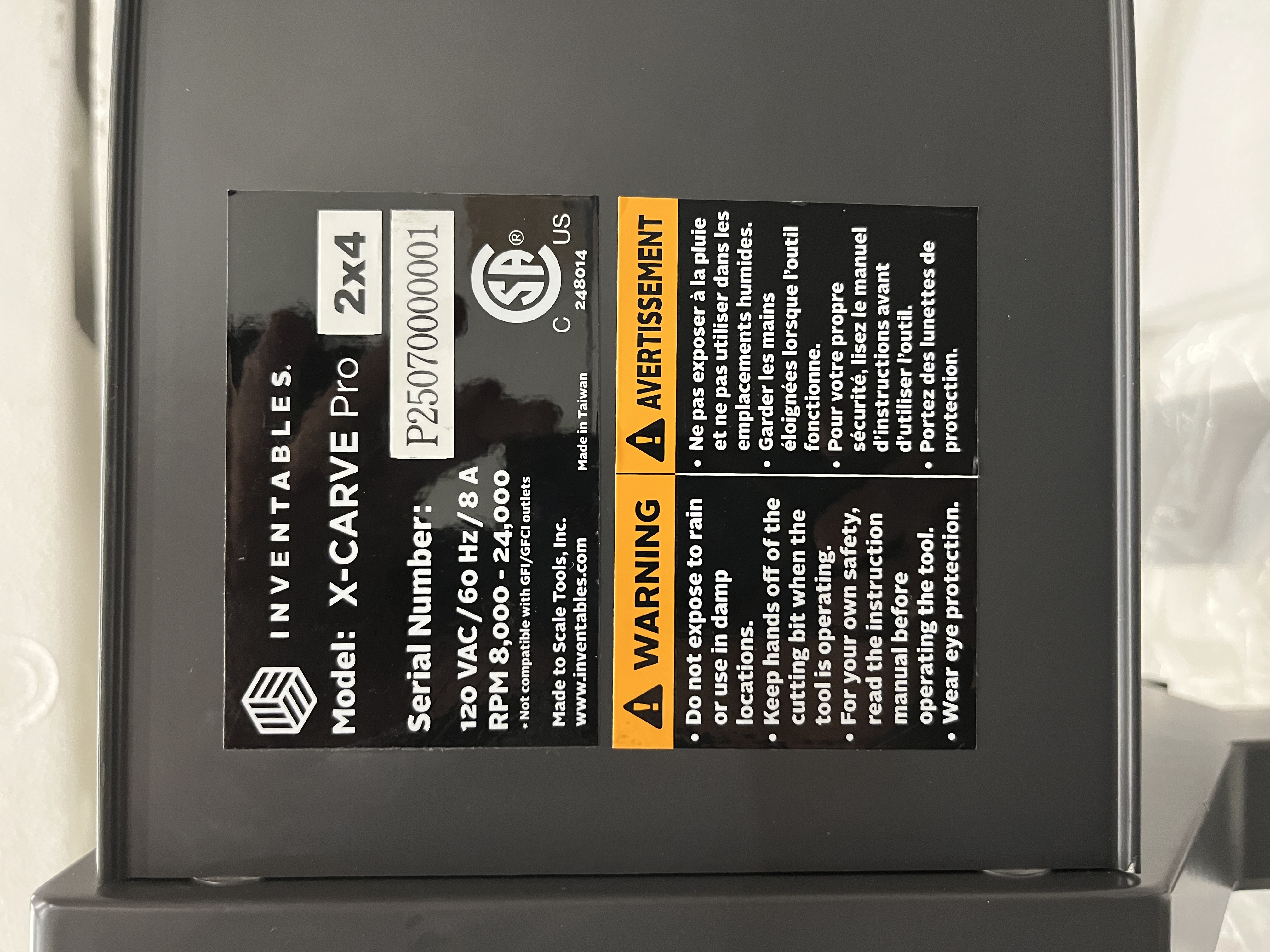

NOTE: If you’re using the X-Carve Pro CSA unit in Canada, use a transformer (shipped separately). If you’re using X-Carve Pro in the US, you do not need a transformer.
CSA Sticker behind gantry, click for details

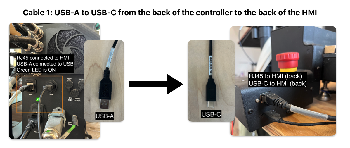

- Connect HMI
- Plug the RJ45 (ethernet) cable into the controller in the port labeled ‘HMI’. Route the RJ45 (ethernet) end of the cable under the machine to where you plan to keep the HMI to connect your computer.
NOTE: The spindle should remain unplugged from the controller until the assembly process is complete.

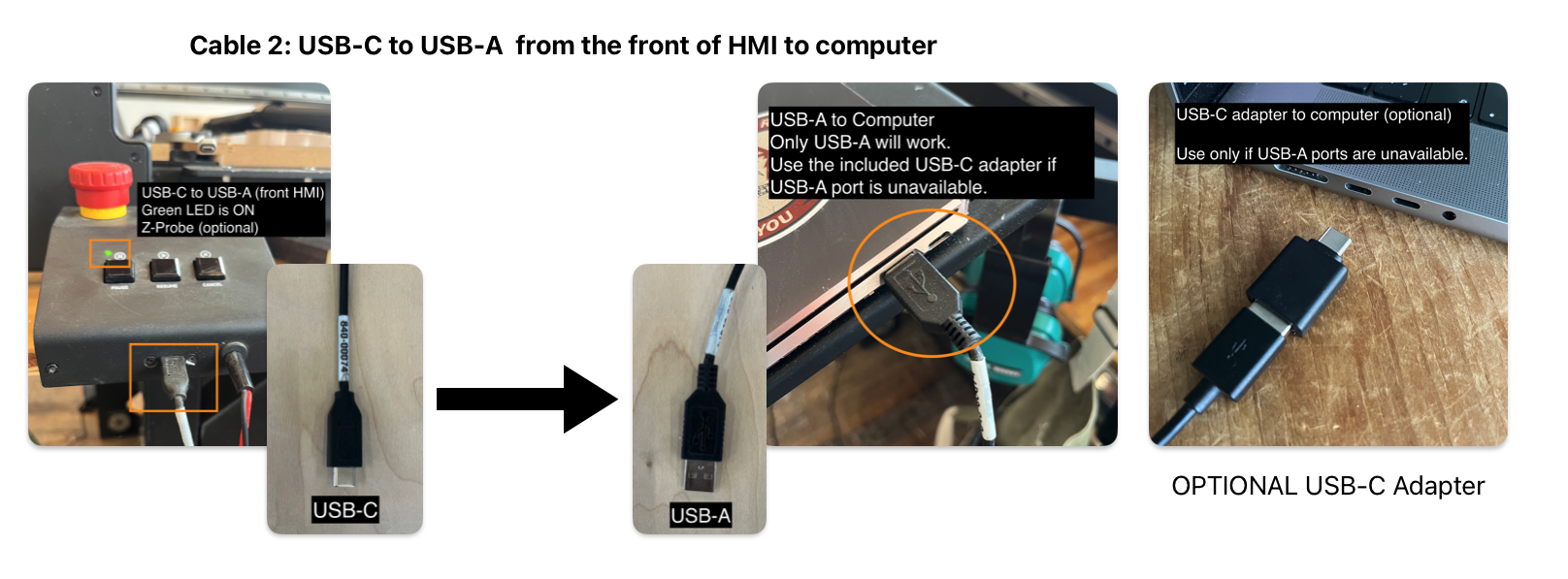

- Plug the USB-A to USB-C 3M cable into the controller in the port labeled ‘USB’. Route the USB-C end of the cable under the machine to where you plan to keep the HMI to connect your computer.
USB Cable 1: from the back of the controller to the back of HMI
- USB Cable 2: from the front of HMI to computer.
NOTE: If you are using the USB-C adapter, the USB-C end will be connected to your computer. USB-C to USB-C connection will not work.
- We recommend having the controller on its own dedicated circuit.
- The X-Carve Pro plugs into a standard non-GFCI 120v outlet. Industrial-grade CNC machines that allow for the spindle speed to be controlled by the operator are powered by Variable Frequency Drives that are not compatible with GFCI outlets.
- Plug the AC power cable into the controller and then into the nearest 15A (or higher) standard outlet.
- The spindle is powered by a variable frequency drive (VFD), and it is common for VFDs to generate some current that flows to ground due to the high frequencies and capacitive coupling between current carrying conductors and grounded elements. This ground current can generate nuisance tripping of the GFI since it creates an imbalance between the current on the hot and neutral lines.
- The X-Carve Pro was not designed to operate with GFCI/GFI outlets. Do not modify or open the controller as this could cause a safety hazard.
