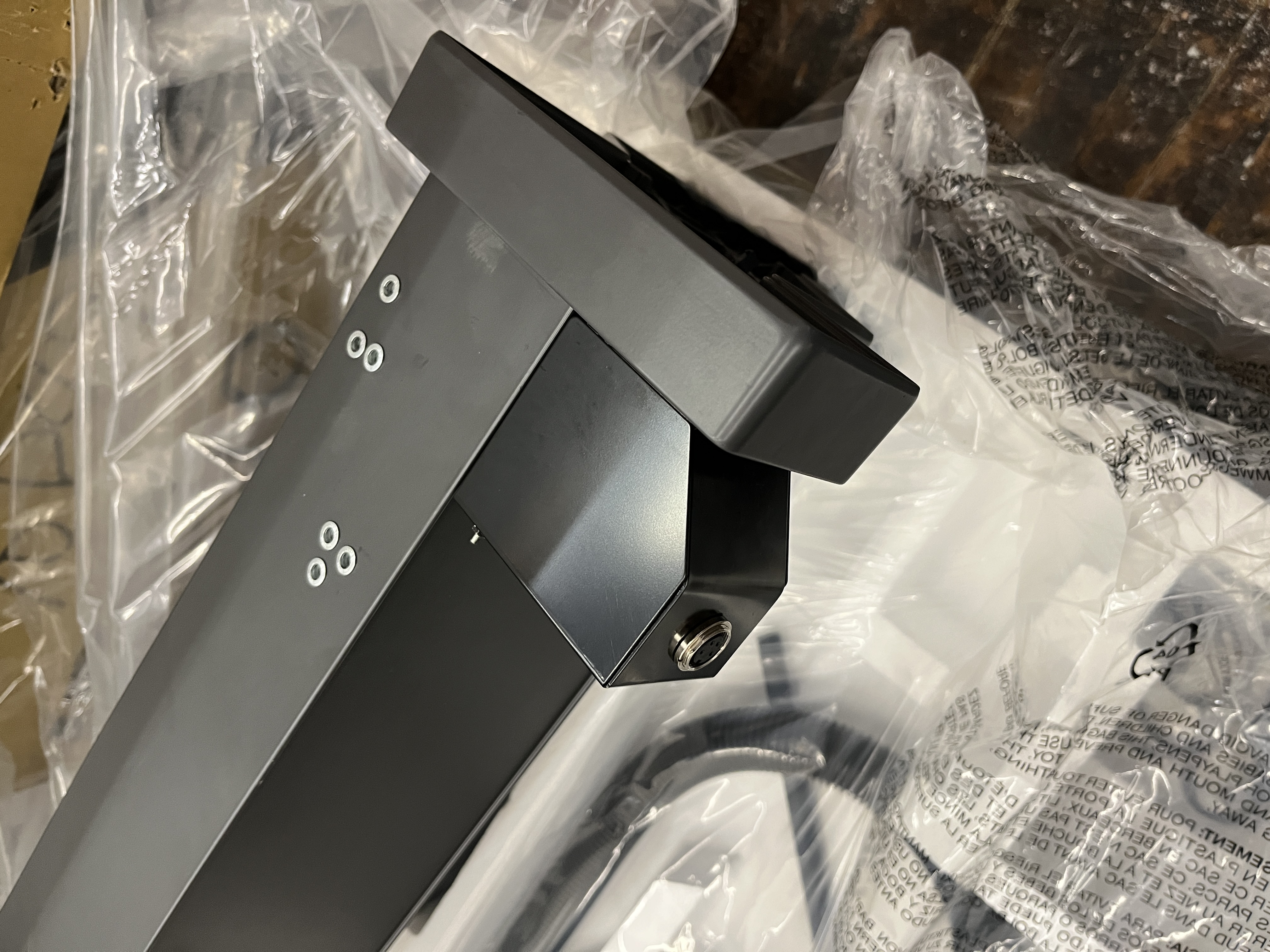

  1. Attach X Axis Riser Covers
    • Use a 2mm allen key and 9x M3x6 flat head screws to attach the Y1 metal riser cover to the Y1 side of the gantry. The riser covers are located under the drag chain in the top section of the packaging.
    • Repeat for the Y2 metal riser cover with 8x M3x6 flat head screws.
      NOTE: Do not over-tighten the M3x6 flat head screws as doing so may lead to the strip the screws.
  2. Connect Motor Cables to Y1 and Y2 Axes
    • Insert the Y1 axis motor cable (packaged separately) into the female connector on the Y1 motor and thread the collar into the connector.
    • Insert the Y2 axis motor cable (packaged separately) into the female connector on the Y2 motor and thread the collar into the connector.
  3. Connect Limit Switch Cables to Y1 and Y2 Axes
    • Attach the Y1 limit switch cable (packaged separately) to the black/blue pigtail coming out of the back of the Y1 front plate.
    • Attach the Y2 limit switch cable (packaged separately) to the black/blue pigtail coming out of the back of the Y2 front plate.
      Note: Pigtail connector should be outside of the housing and secured under the crossmembers with a ziptie. Ensure cable is not getting pinched or touches the ballscrews.
