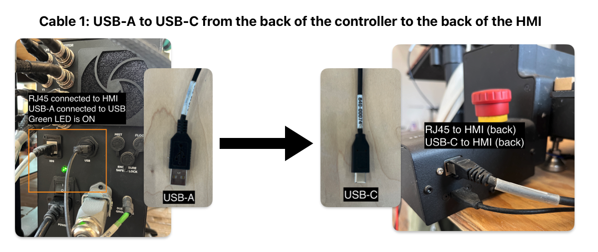

- Connect HMI
- Plug the RJ45 (ethernet) cable into the controller in the port labeled ‘HMI’. Route the RJ45 (ethernet) end of the cable under the machine to where you plan to keep the HMI to connect your computer.
NOTE: The spindle should remain unplugged from the controller until the assembly process is complete.
- Plug the USB-A to USB-C 3M cable into the controller in the port labeled ‘USB’. Route the USB-C end of the cable under the machine to where you plan to keep the HMI to connect your computer.
USB Cable 1: from the back of the controller to the back of HMI

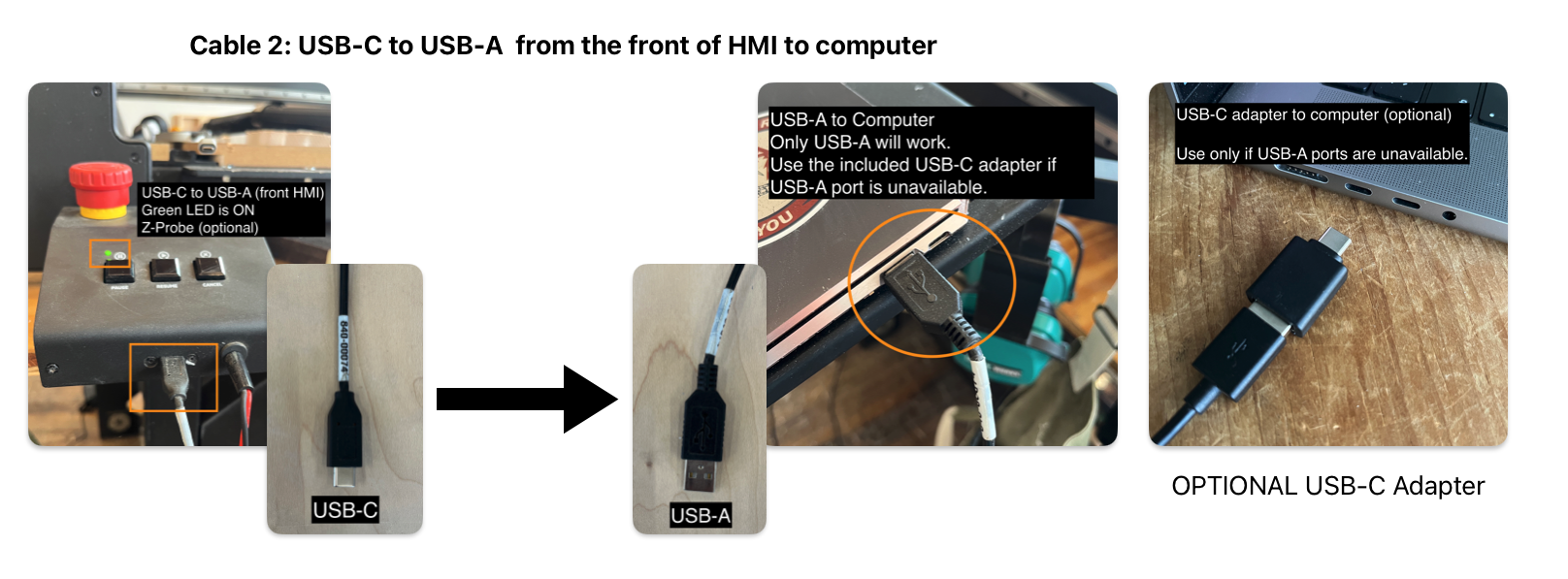

USB Cable 2: from the front of HMI to computer.
NOTE: If you are using the USB-C adapter, the USB-C end will be connected to your computer. USB-C to USB-C connection will not work.
